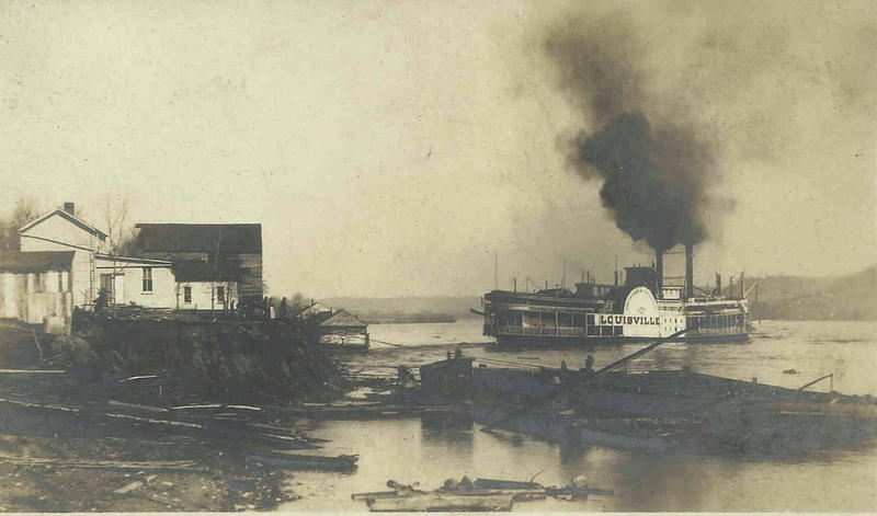

The City of Louisville maneuvering at the Rising Sun, Indiana landing in high water of 1908. Yep, they still ran in high water.

Image from 1908 that goes with first post
