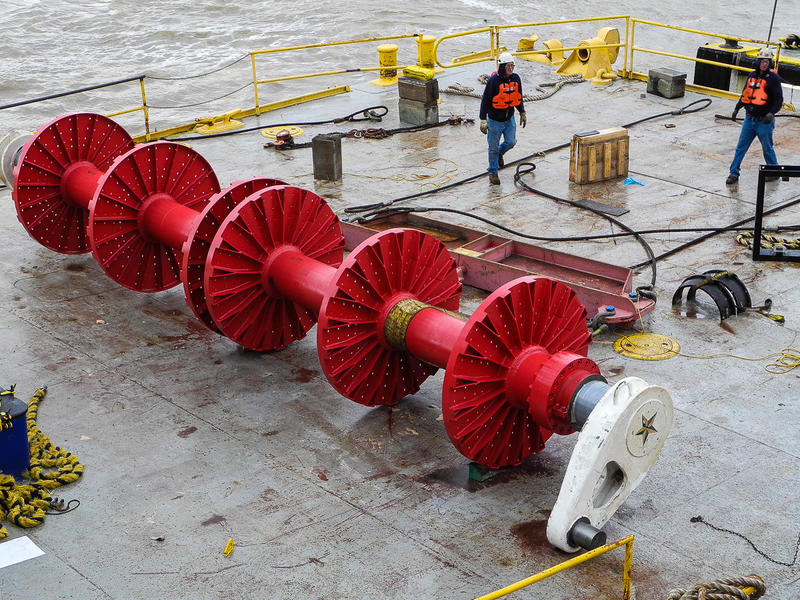

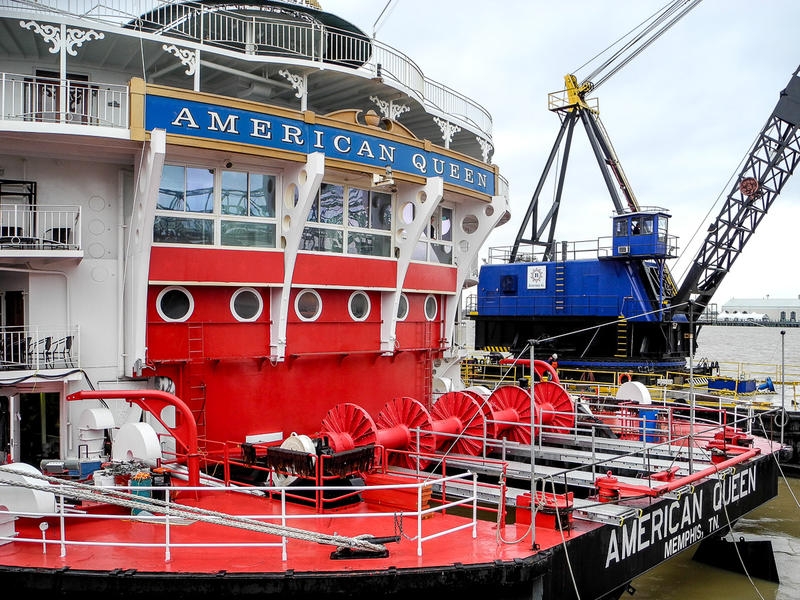

The new shaft arrived just this morning with a fresh coat of paint, 39,000 pounds of welded steel. The rain held off just long enough to set it in the bearings. We have a couple of soggy days ahead of us but when the weather breaks on Wednesday it will be two shifts until assembly is done. We are shooting for a builder’s trial with USCG on the 19th. Wish us luck!8785.jpg8786.jpg8788.jpg

Shaft Update
Hey Keith
New shaft is all welded steel. We looked at “interference fit” like the putty and shrinking but opted for a complete welded solution. The properties of the new shaft are different than the old one. Higher yield strength steel and a heavier wall thickness. Part of the old system includes carving out keyways into the shaft itself. We decided to avoid building in any pressure ridges or weaker areas because of the material that has to be removed. Both solutions will work, just a different approach. The guys have already installed all of the inner spokes on and are about 30% into the outer ones. We should be rolling dockside this weekend to adjust the bearing and the engine timing. If all goes well it is a builders trial on Tuesday and head over to New Orleans Riverwalk for the duration.

Only About 3000 Bolts To Go

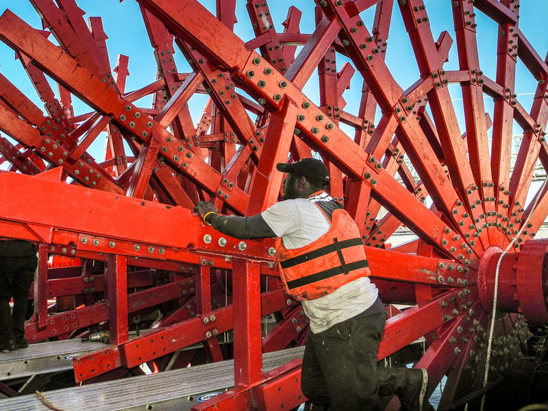

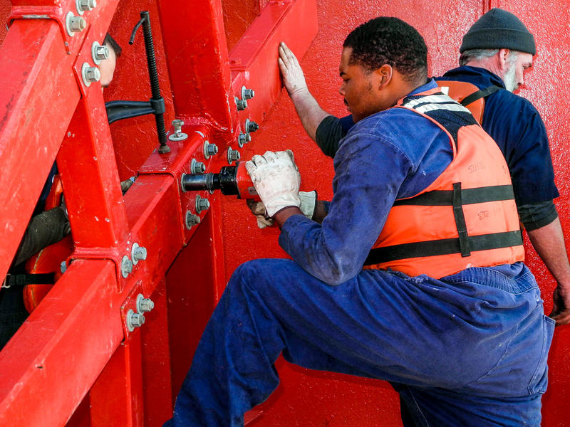

The weather has cleared and we have shifted into high gear!8789.jpg8790.jpg8791.jpg

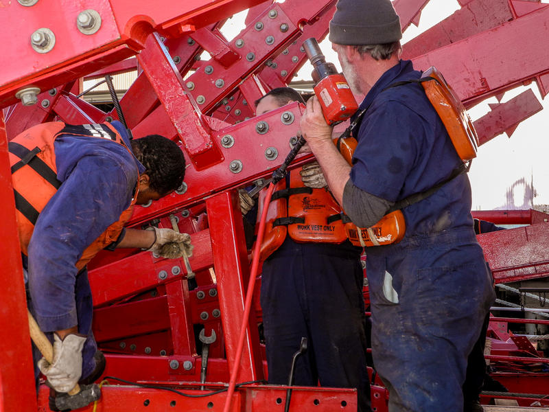

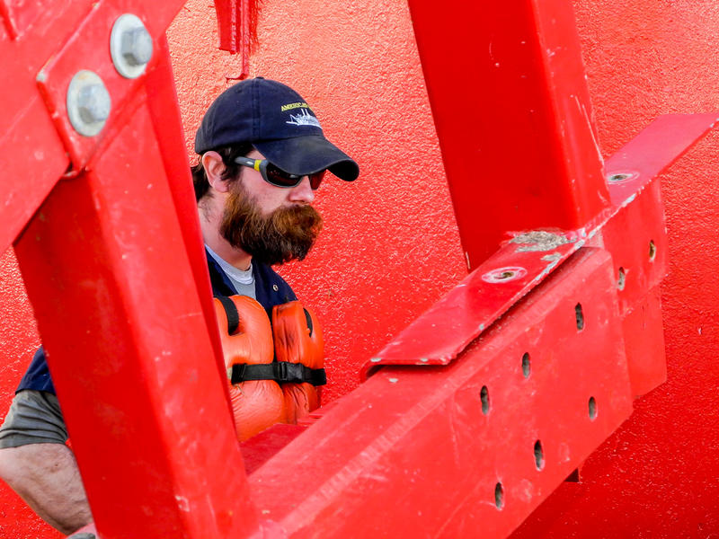

A couple more pictures I took today. Looks like we will start putting bucket boards on tomorrow8792.jpg8793.jpg

Posts: 13
AQ Paddlewheel
Hi Ron
The wheel on the AQ is mostly wood. She has a heavy steel shaft for her center axle and the “spider flanges” that the spokes bolt onto are welded to the shaft. The spokes are actually two pieces (1) 4 X 8 x 8 and (1) 4 x 8 x 6 joined by a steel bracket. We use a free of heart oak for the spokes. There are 108 spokes in total. There are 72 bucket boards that are Douglas fir, 2 X 12 X 16 and we use them double width. Everything is held together with brackets and jacking bolts. 5000 bolts to be exact, we have counted!

Big Red Wheel Is Ready To Roll

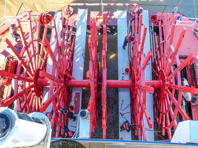

We finished up at dinner time tonight! We will start warming up the bearings tomorrow and a trial run on Tuesday!8796.jpg
