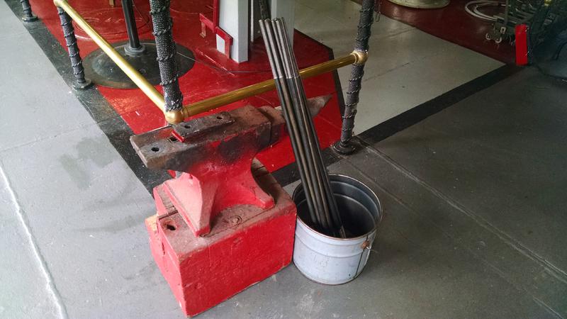

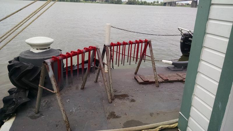

Here are a few shots of our not-so-secret recipe for making wheel stirrups. Stirrups (for anyone unfamiliar) are the hardware fastening the bucket planks to the wheel arms. We have the tools and equipment here on the Belle to make our own. The first pic shows our anvil (origins unknown) and some round stock threaded on our pipe threading machine (believe me, there is no fun in threading something like this by hand if it isn't necessary). With a decent torch you heat and bend it into the shape you see in the second picture. With a little paint to dress it up, you have a usable part to repair the paddle wheel. These pictures only show a small portion of what's needed for this wheel. We have 24 pieces here, but there are 192 of these total.9823.jpg9824.jpg
In 1962/63 Alan Bates spearheaded rebuilding the wheel. At that time there was still one blacksmith shop in Louisville. If my memory is accurate, it was located at 5th and York. Alan had the blacksmith make all the stirrups and other iron parts we needed for the project.
