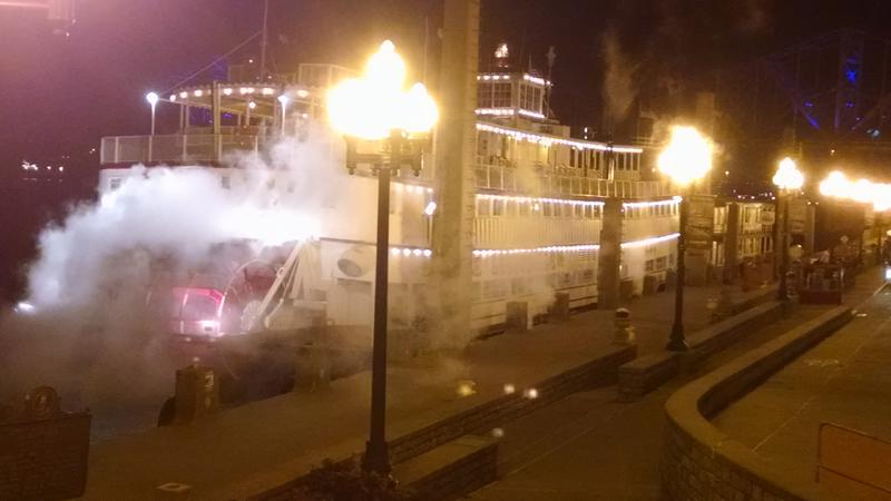

I couldn't resist spinning the turbine one last time for the season as I worked my last evening cruise! Once a common sight to see the turbines' exhaust billowing steam from the stern (especially if Chief Mike Pfleider was on watch)!9422.jpg

That's a great picture, and for the uninitiated on this board, NO, the paddlewheel is NOT on fire!

During one of the Tall Stacks in Cincinnati while that engineer stood watch the engineroom phone rang from the pilothouse during a moonlight run. Someone reported to the Cincinnati Fire Dept. that the wheel was on fire, and the Fire Dept. contacted the boat. The wheel really wasn't on fire then either.

Frank X. Prudent;33710 wrote: I know another engineer on the BELLE that would rather use the steam turbine generator too when he was onboard!.
What else would that engineer have used to generate steam? Or can this boat be moved some other way? (sorry for the beginner question!)

What Frank is referring to is his Dad, who was an Engineer on the BELLE several years ago. What you are seeing in this picture is the exhaust from the steam turbine generator (light plant) on the BELLE. That equipment is still on her, and is still used from time to time, but often the crew of the boat elects to use a diesel generator. I cannot speak to the specific reasons they like to do this. Please understand this is not the motive power for the boat -- she can only be moved by using steam, as the main propulsion engines are steam, and the only engines on board. The steam generator (light plant) exhausts its steam directly out through the stern; the BELLE is non-condensing, which means all steam used is exhausted to the atmosphere once it is used.

Not a bad idea. My background of a UP locomotive gushing a thundercloud of steam needs a break. I had also thought that the steam from the Belle was from the engines warming up?
Bob's right. The steam that exhaust forward of the wheel is from the steam electric generator and the steam steering rig engine. The steam from warming up the engines goes out of the 'scape stacks. Also while warming up and handling the engines there is bit of steam that goes out the cylinder cocks that exits down near the waterline. When the boat is out running the cylinder cocks on both engines are almost completely closed and open just a hair.
Dad liked to use the steam generator because it's much more quiet than the old diesel generator was.

I always preferred the turbine over that diesel, even though I was usually the fireman and had to fire harder. I'd much rather listen to the roar of the burners than the racket made from that diesel I could here all the way up in the boiler room!
you jogged my memory. I should have remembered the cylinder cocks as we did the same thing on the Graceful Ghost. This we did so the people on the top deck would not get a shower bath. FYI we had electrics on the Ghost but used batteries and inverters instead of a noisy generator. This powered sound system, lights, and ceiling fans.
When we had the second turbine (on the port side) it exhausted, of course, on the port side of the paddlewheel. Chief Pfleider favored the stbd. turbine, as the oppposite watch would run the port. We still have that turbine (mostly assembled) in storage, along with nearly enough spare parts to build another. In fact, I pulled the voltage regulator from it last season to keep the stbd. turbine running.
