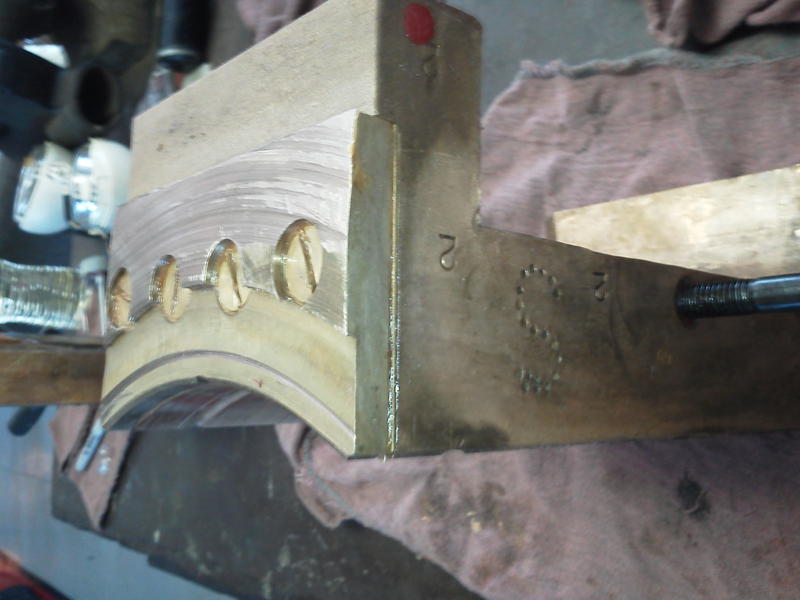

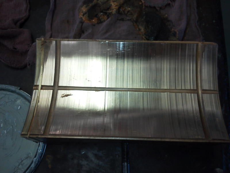

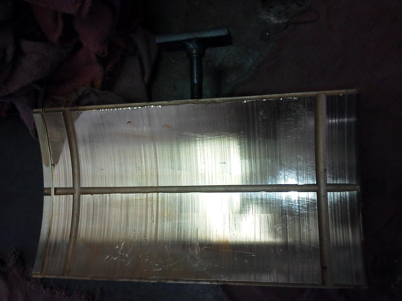

Yes, I had one of the wheel bearings break on an excursion sternwheeler, back in the 1980s. Fortunately this happened while we were simply shoving ahead on a slow bell, at the dock, loading passengers. And the wheel didn't climb very far out of its location because the drive chain came off immediately. Obviously this was not a steamboat, but I'm sure it happened to other steam/diesel sternwheelers.
I'm not sure if that "Babbitt" bearing was original to the boat's construction in 1929, but it was old, and we replaced them with Dodge roller bearings. It's my understanding that prior to modern roller bearings, steamboats used these rather simple Babbitt bearings.
While I've never seen a bearing come apart while underway (nor do I care to ever have such an experience), I've certainly heard them make an unholy din! The old saying I can recall, though, is: "It's better to hear them than smell them!" I have experienced very tight bearings and, unfortunately, had to go out or send some poor soul out to the wheel with a hose to cool them down! I always admired the pipe system on the Delta Queen designed to keep the journal bearings cool. If your bearing temp does reach or go above that critical temperature and you do not cool it down before you stop the wheel, then you're sure to have a mess on your hands when trying to start the wheel again as your bearings become one with your paddlewheel shaft! The bearing designs of which I'm familiar consist of three separate pieces. One piece--typically called the "pillow block" bearing is, as the name implies, the bearing on which the paddlewheel shaft rests. The other two are wedged on each side of the bearing. These side blocks have steel wedges driven between the bearing and the cradle fixed to the engine timber. There might be shims added to one side of the wedge to hold the wedges farther up towards the bearing cap where there are jacket bolts for adjusting the wedges. Chief Howe can tell a lively tale of the first set of journal bearings fabricated for the Mississippi Queen. As he can tell it with much more fanfare than myself, I won't say anything more than that first set of bearings were made of a much too hard bronze casting and immediately overheated the first time they rolled the wheel! Anyway, I have a few shots of some of the Belle's journal bearings. These also show a brass lip extending past the width of the engine timber to catch any side thrust. The Belle's bearings are designed with a removable wear plate for the side thrust (as one picture shows) specifically designed to prevent her shaft from the tendency to drift to the port side--another story in of itself!8917.jpg8918.jpg8919.jpg
