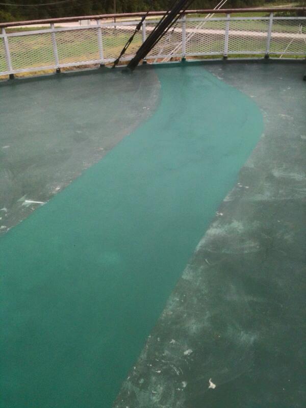

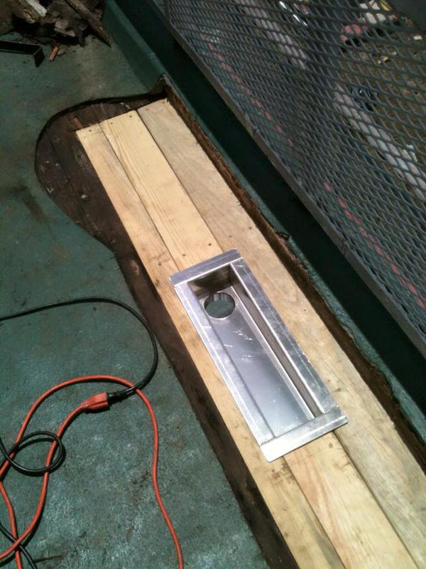

23 new pictures of the ongoing restoration have been posted on Facebook, work is progressing nicely. For those of you not on Facebook I've attached the maximum number of pictures the system will let me do.9624.jpg9625.jpg9626.jpg

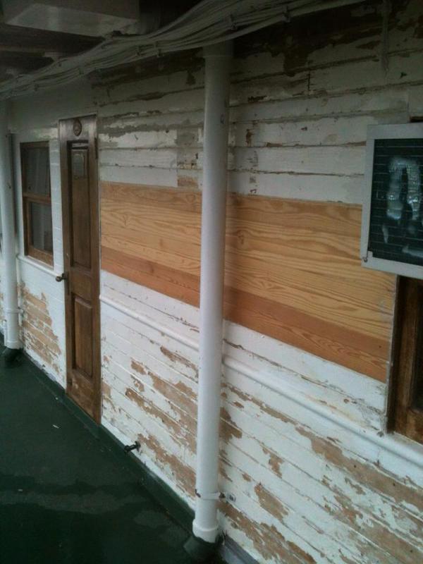

I once helped rehab a porch on an older, Victorian home. The floor on the porch was made of tongue and groove wood. What we found was back when the house was built, the wood was milled to a true 1" thickness, the wood today is milled to about 3/4" thickness (kinda like today a 5lb bag of sugar contains 4 lbs). We had to get specially milled tongue and groove to replace the rotten wood in the porch. Has the DQ rehab run into this kind of problem?
Posts: 87
My guess would be yes based on my working on my 1885 house but the person who would know best is Capt. Mike Williams. Hopefully he'll see this post and fill us all in. I'd also venture to guess that the same thickness problem is on the siding that was replaced.

Jim Reising;34704 wrote: I once helped rehab a porch on an older, Victorian home. The floor on the porch was made of tongue and groove wood. What we found was back when the house was built, the wood was milled to a true 1" thickness, the wood today is milled to about 3/4" thickness (kinda like today a 5lb bag of sugar contains 4 lbs). We had to get specially milled tongue and groove to replace the rotten wood in the porch. Has the DQ rehab run into this kind of problem?
Jim,
When speaking with Captain Mike yesterday about how the boat is progressing and such, I posed your question to him. He provides the following:
"We were able to find tongue and groove wood of the correct thickness, which is referred to as 5/4" (in reality is is 1-1/8"), but it was not of the correct width.
Our ships carpenter, DJ, who is quite the skilled craftsman, then took the planks and ripped them down to the correct width, and cut the grooves back in using the on-board table saw."
Given Captain Mike's long history with the boat, and the fact he began his career on her as the boat's carpenter in 1980, hes just the man for the job and knows where to look and find the correct materials.
So in short...yes we have run into "issues" finding the correct wood, but nothing that hasn't been easily overcome.
This is extremely reassuring news to me. I was somewhat concerned when I saw the beam replacement is pressure treated wood. Modern lumber is nothing like what was used in 1927.

From the pictures, it looks like they are doing an excellent job with the restoration, I really was just curious if there was a difference in wood then and now and how they dealt with the differences.
The Big E himself, Capt. Wagner, was amazed at the quality of the wood used in the original construction and how well it held up as opposed to the materials used in the conversion at Dravo in 1947. Even in 1967 the wood used by Dravo on the boiler and texas deck extensions was starting to rot while not a stick of original construction wood had deteriorated.
