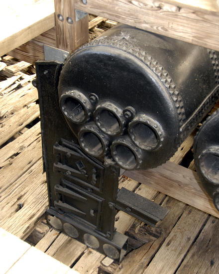

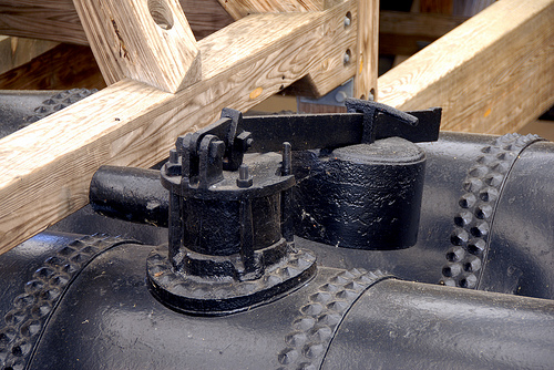

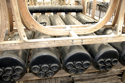

Mike, here are a few views of the partial remains of typical mid-nineteenth century hand fired coal, steamboat boilers, these pictures from the U.S.S Cairo, a Northern civil war ironclad, that sank and was raised, currently for view in Vicksburg, Mississippi. Note the rigid steamdrum on the top back of the watertube barrels and the lack of any compensation for changes in expansion. And the weighted relief valve where addional weights could be added "illegally" for more power and in doing so ended the career of many a fine steamboat. The second picture shows a partial bit of hardware and firebox doors to fuel the boilers with hand shoveled coal.2057.jpg2058.jpg2059.jpg

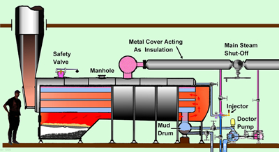

And here is two pretty good sectional views through boilers of that time period.2060.jpg2061.jpg

Bruno there are a lot of stories about moving the pea on the lever or hanging a few grate bars on it to raise the pressure. Chet Foster, a very fine engineer, told me once that it was better to jam a post between the lever and the ceiling so that the valve could not possibly open and cause a loss of water. He said that the boat was usually using the steam as fast as it was produced so there was little danger - YEAH! The real problem was cooling her down to ordinary pressure when the need for high pressure was passed. That took careful closing of the throttle and cautious pumping or injecting more water. Those lever safety valves were legally "grandfathered" into the 1930's.
There was no reason to doubt Chet. He was Kenny Howe's mentor and Kenny is the best today.
