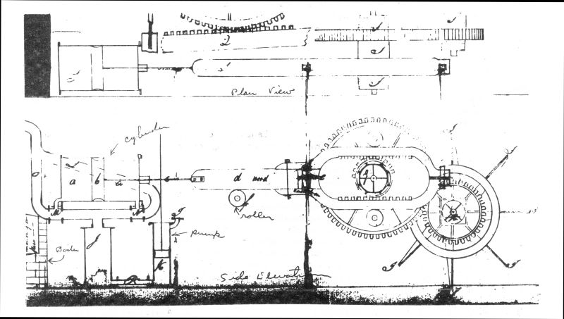

Hi everybody,
In 1980 I corresponded with the late Yeatman Anderson III. He was then curator of rare books & special collections of the public library of Cincinnati and Hamilton County. He was about to send me drawings of the W. W. O’Neil’, but they never arrived.
Does anyone know of the existence of such drawings (or any other drawings of western rivers paddle steamer engines & boilers)?
Maybe we can all join in an compile a list with sources of books, magazines, collections etc. Over the years I have found quite some material. I am compiling a list of my findings and I will post it here.

In one of the issues of the Egregious Steamboat Journal, this article and drawing appeared. This is the only mentioning I ever found of it. No other referrals on the Internet. Is there anyone who knows more about this?
“The Earliest Steamboat Engine?
In this issue's photo essay on sternwheels, we mention the difficulty involved in connecting early steamboat engines with their sidewheels. For some reason, a connectingrod and crank were not used. Instead, the early builders came upwith bizarre ideas to connect engines to sidewheels.
Overcoming complexity with simplicity was the major engineering hurdle. Most assume that Fitch, Evans, and Fulton are the main figures behind the early boats. Not so. There are many others. John H. White of the Smithsonian has sent the accompanyingdrawing showing Griffin Green's steamboat engine of 1796. This engine and the boat it powered were built; however, the project went bankrupt before it was completed in 1798-99.
What happened to this early steamboat engine is uncertain. Green is a name that the books devoted to early steamboat history overlook and yet Jack White feels that this is the earliest extant drawing of an Ohio River steamboat engine. Nicholas Roosevelt built the New Orleans in Pittsburgh in 1811. Greene settled at Belpre, Ohio, in 1789 and built a steamboat 15 years before the New Orleans. A quasi-pittman evidently works rack gears. Possibly through ratchets, the engine's reciprocal motion is converted to rotary.”
(drawing will be uploaded shortly)

Joined: 12 years ago
Posts: 21
